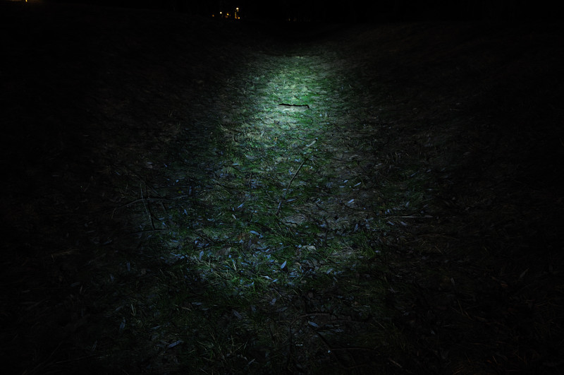

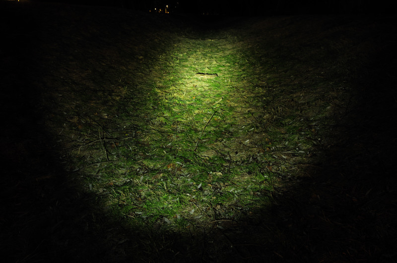

    Measuring the brightness at 1 meter gives an idea about the throw. This is not only depend on the amount of light from the flashlight, but also the size of the led and the reflector. Sunlite has a very good reflector and a small led, this gives a good throw, next in line is Fenix. Preon and IlluminaTi has a wider beam. ET10 has a very wide beam.
    Beam profile
    4Sevens Preon I, Titanium IlluminaTi, VersaTi ET10
    Fenix LD01 XP-E, Fenix LD01 XR-E, ITP A3 EOS
    LiteFlux LF2XT NiMH, LiteFlux LF2XT LiIon
    4Sevens Preon II, Sunlite Slim white, Sunlite Slim warm white
    Sunlite Slim2 white, Sunlite Slim2 warm white, Fenix LD05
    Streamlight Stylus Pro, Sunlite SlimJr

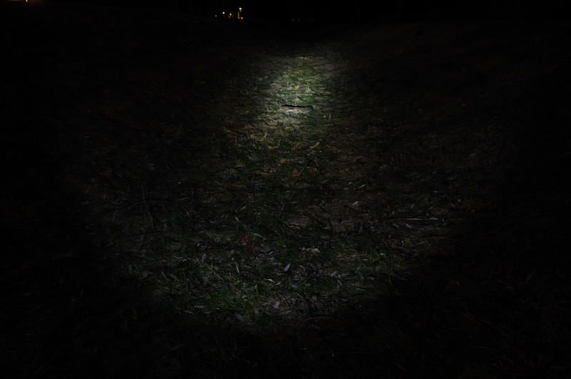

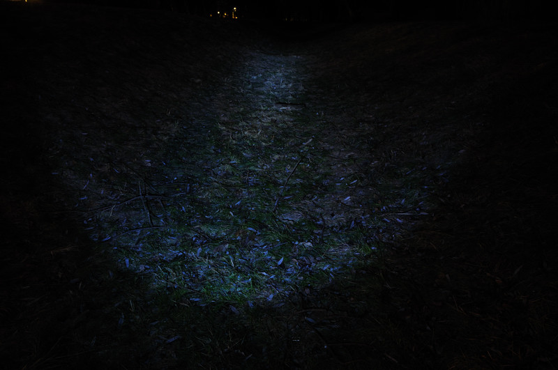

    Beam profile, reduced exposure

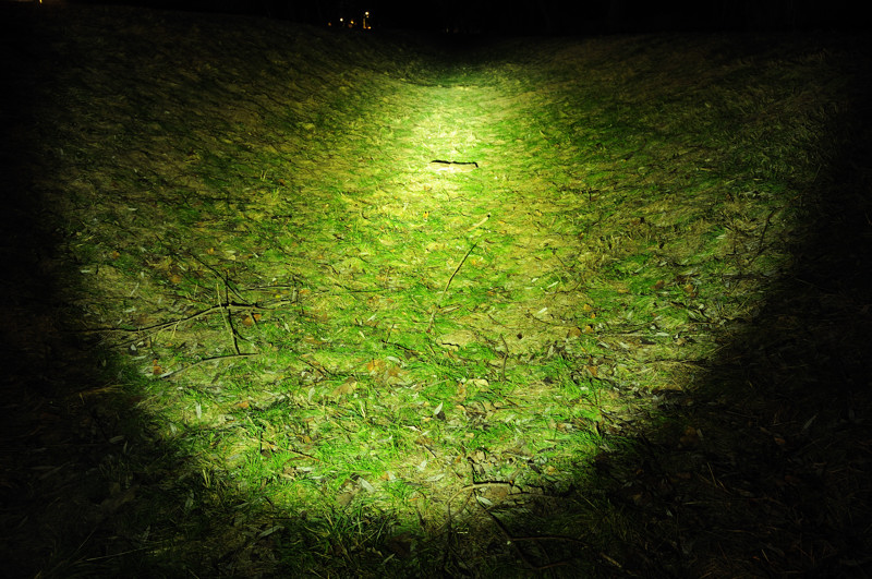

    4Sevens Preon I
    This flashlight has 3 levels and exists in both twist and switch versions.
    Read more about the light and see some pictures in my Danish review
    Low, medium, high:
    Low:
    Medium:
    High:

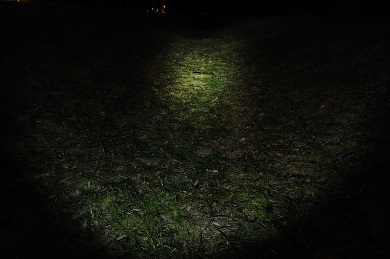

    Titanium IlluminaTi
    This light has 3 levels and twist control.
    Low, medium, high:
    Low:
    Medium:
    High:

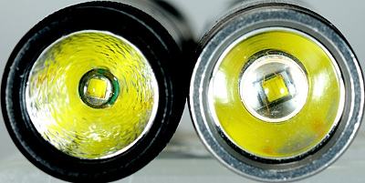

    The picture shows the stainless steel version, the regular version looks exactly like the LD01 XP-E show above.
    This picture shows the two versions from the front, the small led is the XP-E and the big led is the XR-E version.

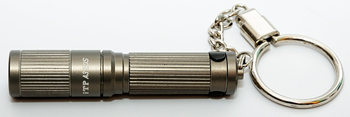

    The Maratac and ITP A3 EOS are basically the same light, just with a different look, i.e. all (light) measurements and beamshots for ITP A3 EOS are also valid for Maratac.
    In Europe I believe that the ITP is the better buy and it also has a better hole for a split ring (But the Maratac looks better).
    Here is a picture of both lights:
