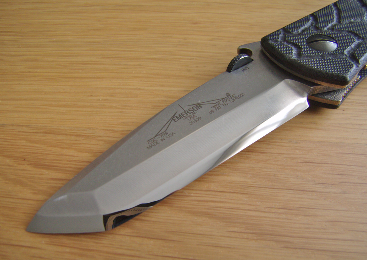

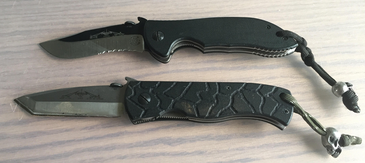

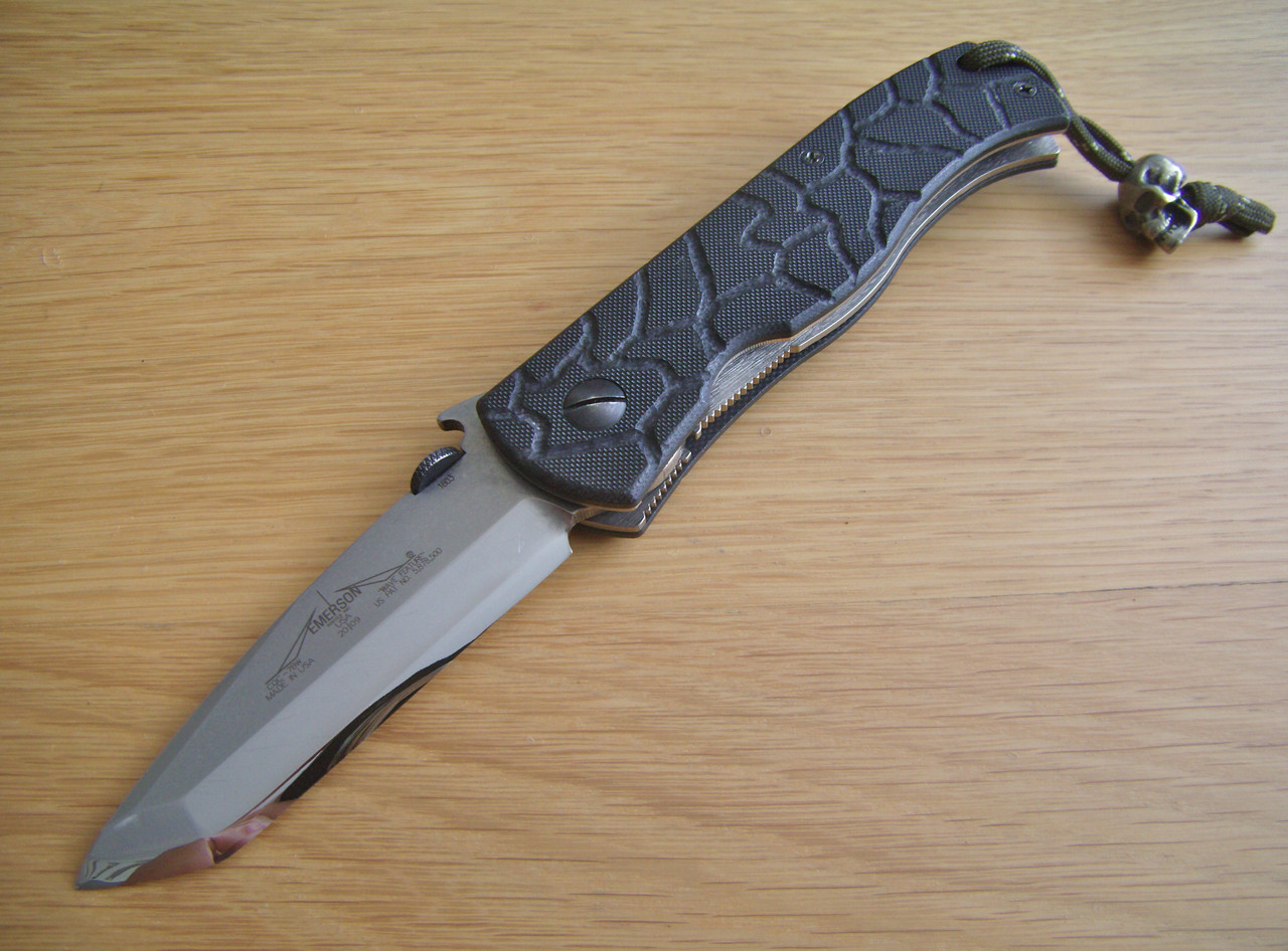

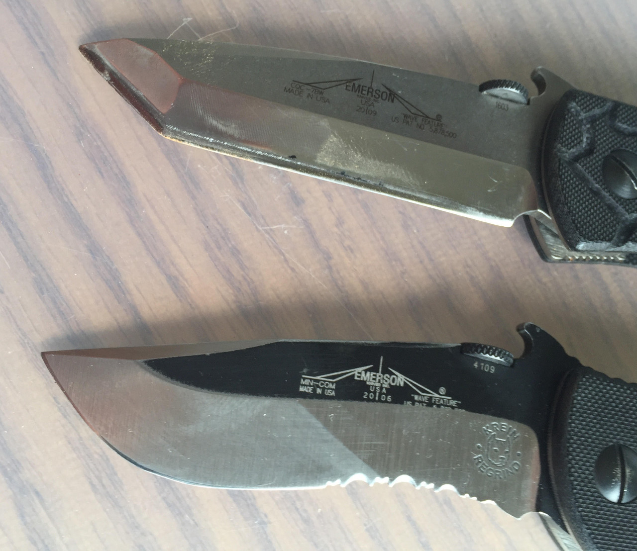

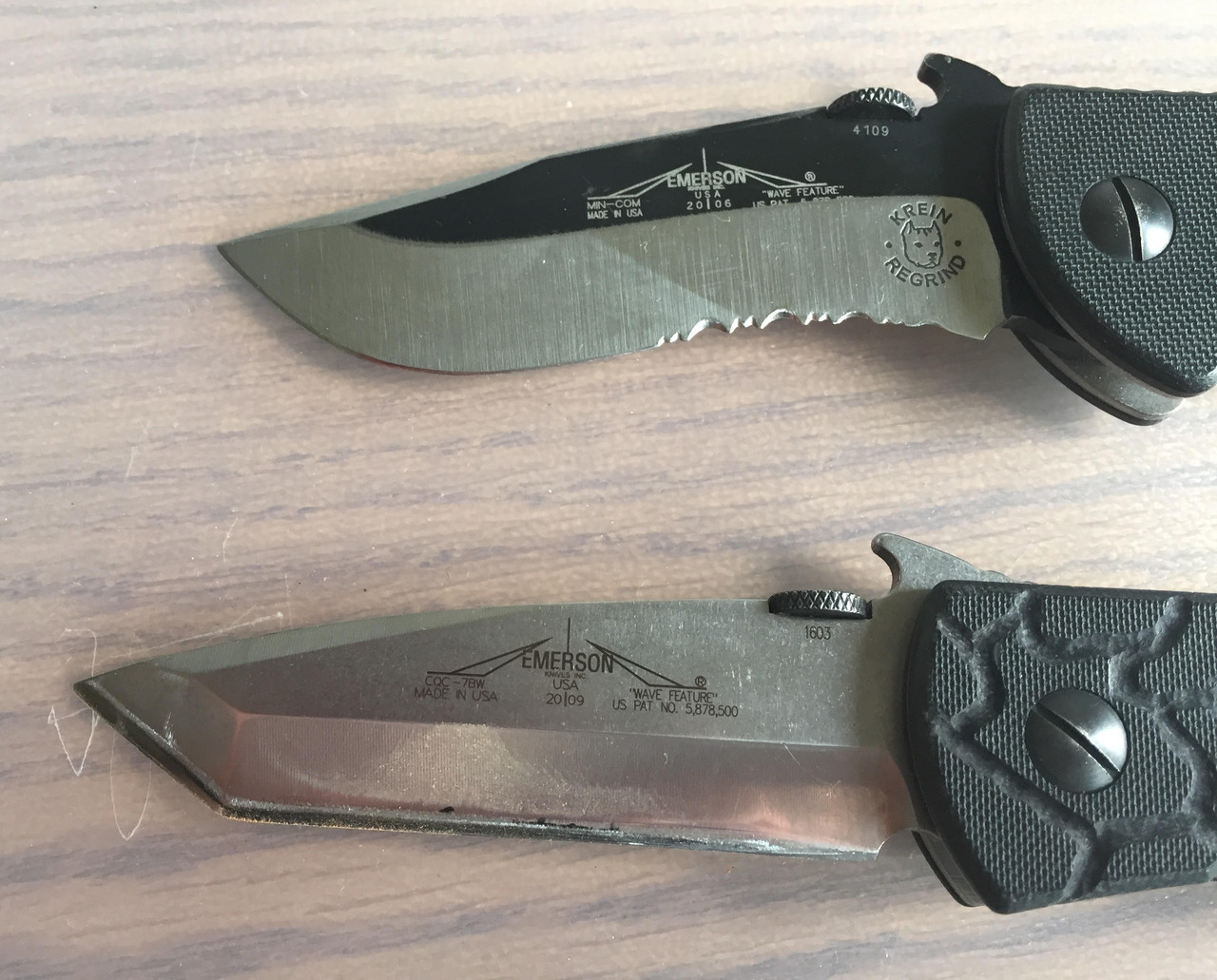

    Several years ago i got sent these two user Emerson folders from neighboring country Belgium; a Commander model with a Krein regrind and a CQC7 model.
    The owner was unable to get them sharp again with only his Sharpmaker, and the request was also to give the new edges a bit of bling.
    As they came in:

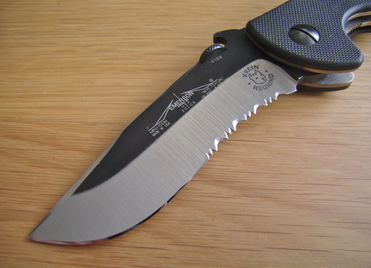

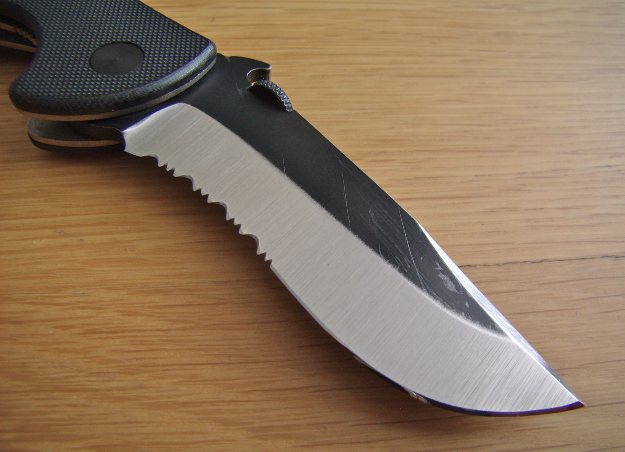

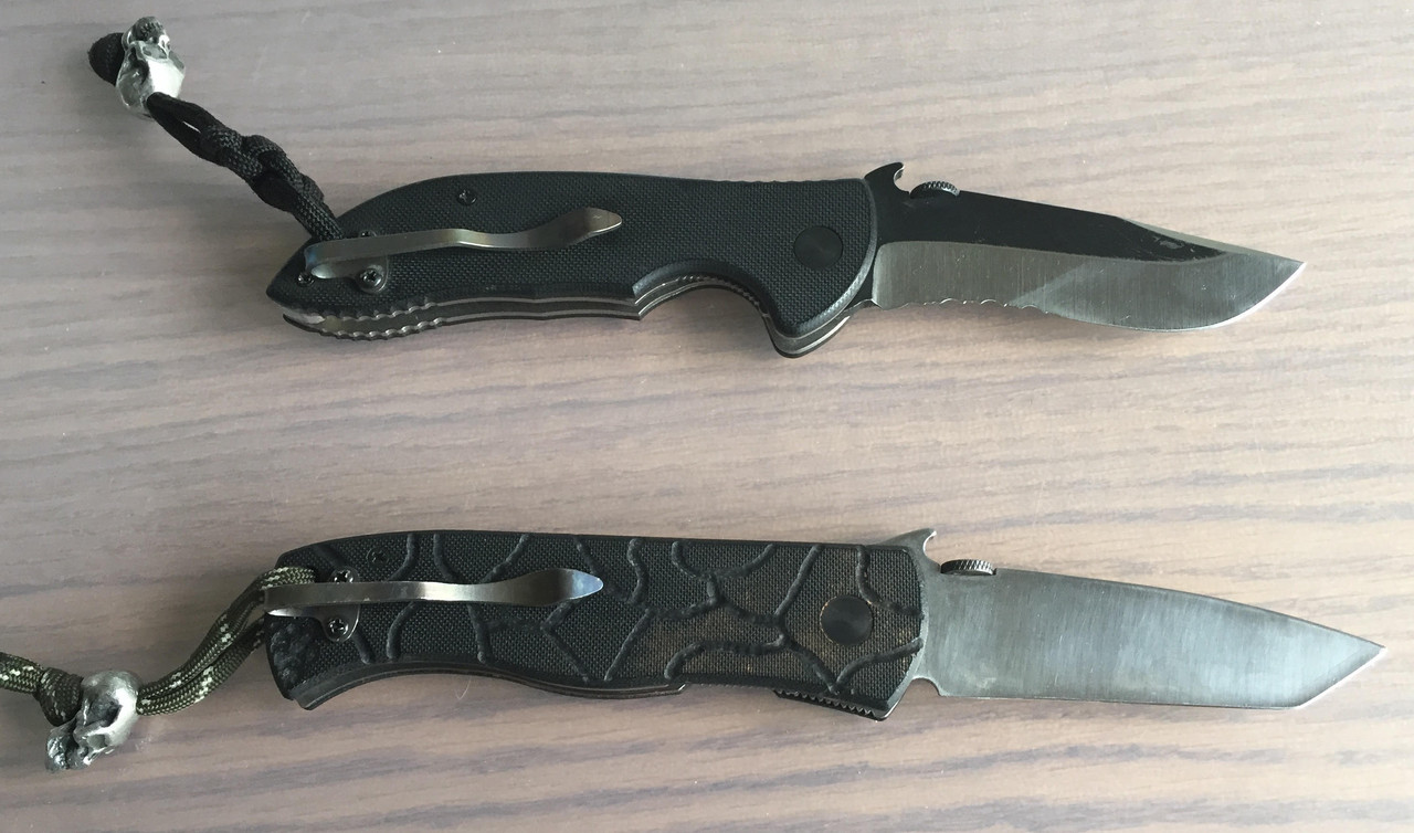

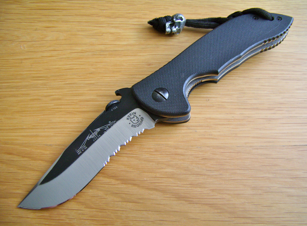

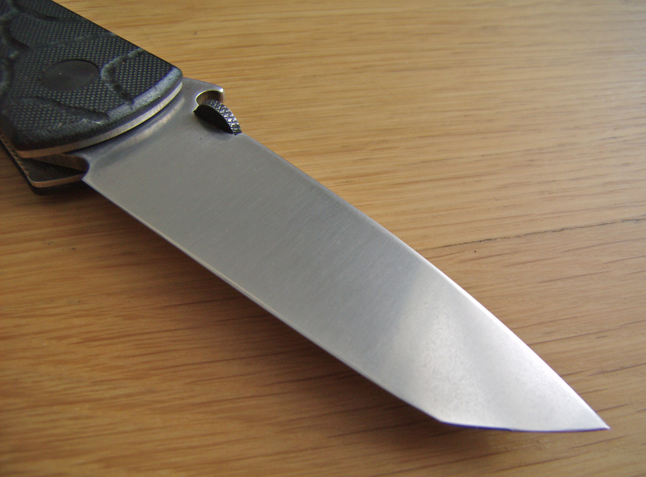

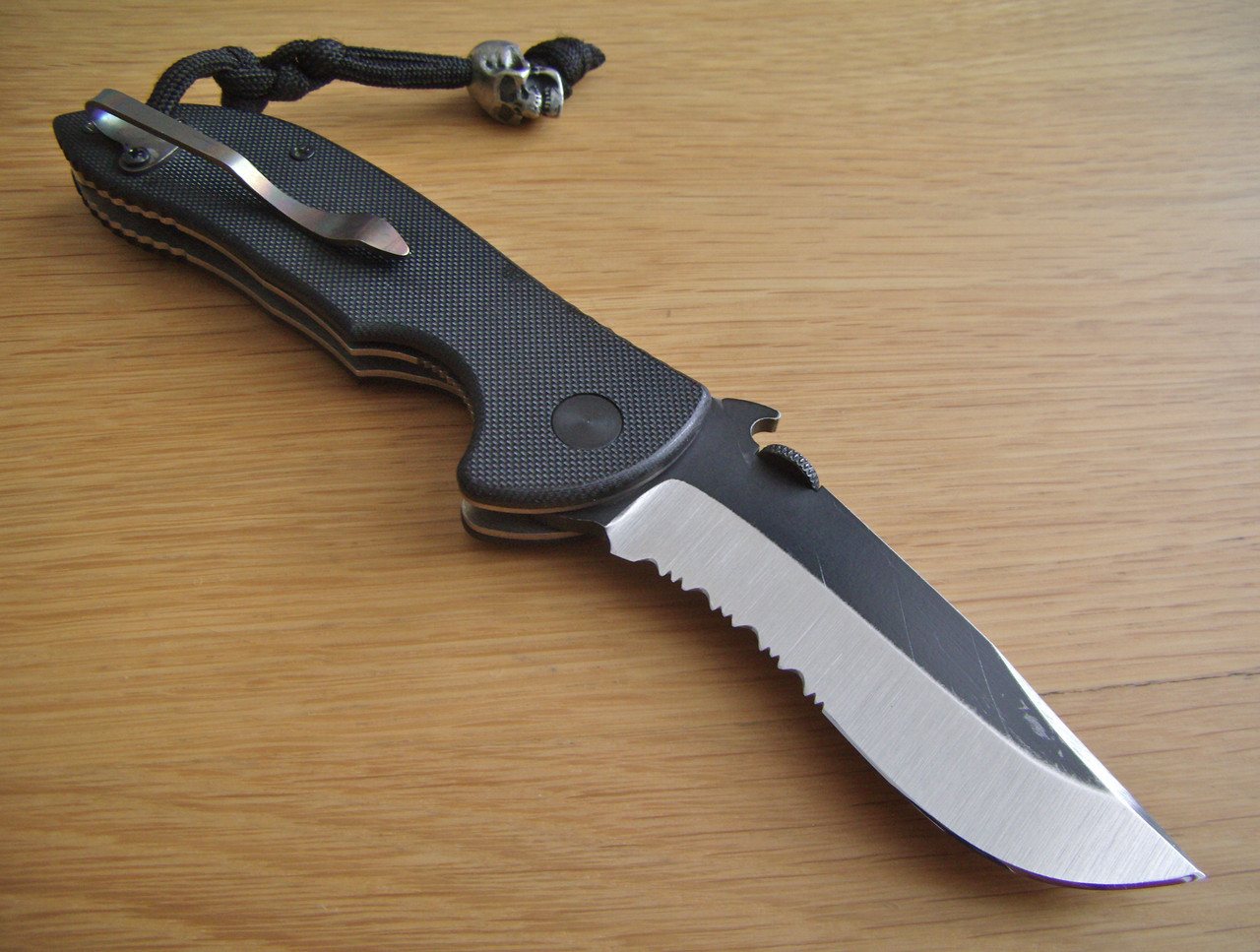

    After sharpening/polishing.
    On the CQC7 i made the asymmetric bevel a bit wider to remove all different scratch patterns, and just touched up the existing mini-bevel on the other side.
    Both knives could now be easily touched up on the Sharpmaker again and the owner was happy, :)
